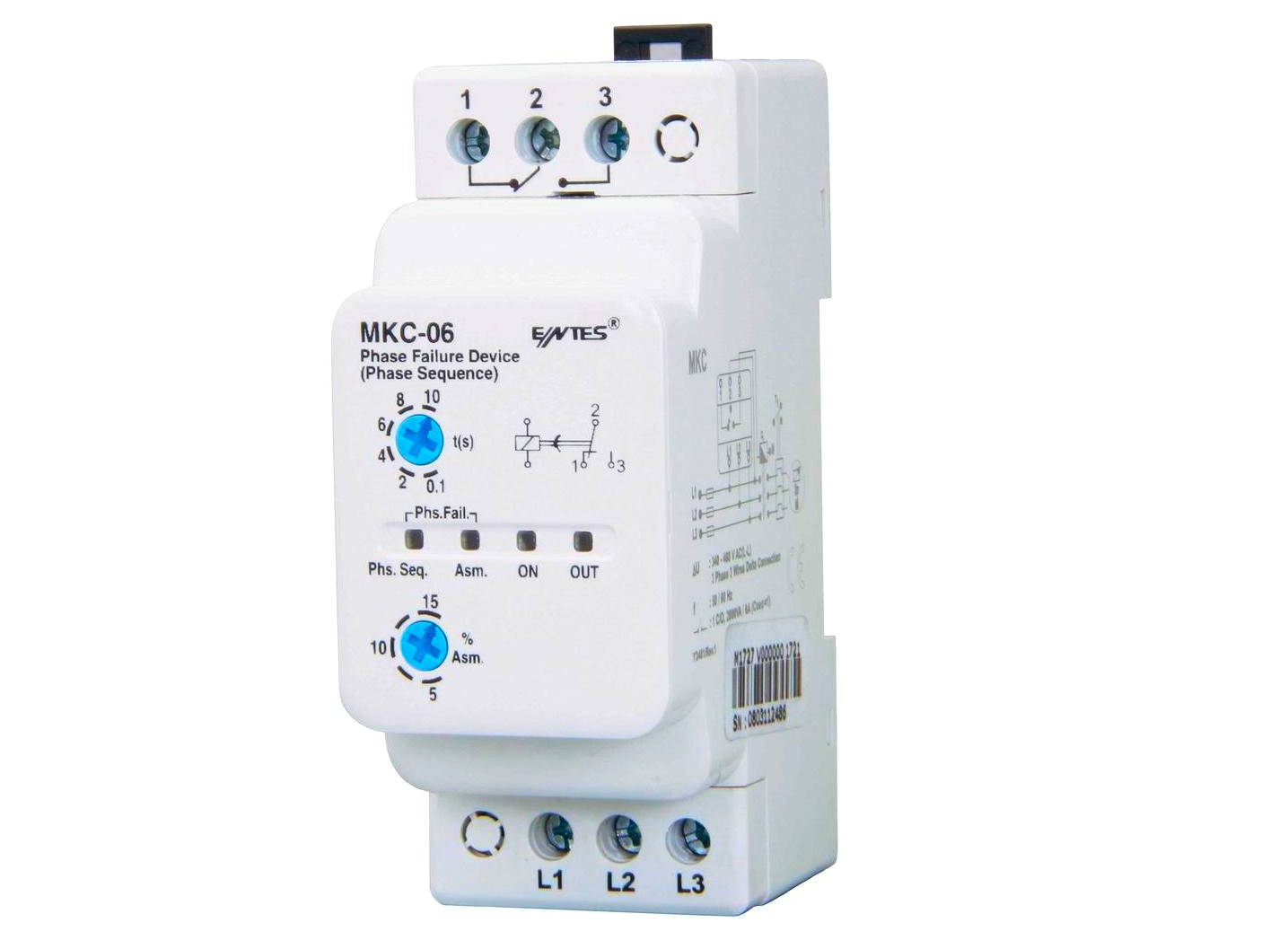

What is a phase failure relay?
A phase failure relay is an electronic protection device, which monitors the three-phase AC supply and generates a digital output if any phase fails. So for example, if the Y-phase fails, then the relay will monitor this and quickly change its digital output. This output can then be used for further interlocking. When selecting this relay, consider your voltage ratings, frequency, and phase configurations. It can be DIN-rail mounted, panel-mounted, or plug-in type.
There is a nominal timing to check the failure inside the relay. When the timer elapses and still a phase has failed, the digital output will be generated. The output will be in digital form and either NO (normally open) or NC (normally closed). This output can either be used as an interlock in an electrical circuit path to cut off the supply or be fed to an external controller like PLC to control the output accordingly.
Phase Failure Relay
