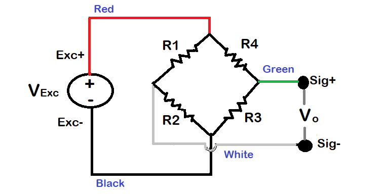

What is a Wheatstone’s bridge? and strain gauge load cell cable color assignment?
The Wheatstone bridge is a configuration of four balanced resistors. If all resistors are balanced meaning R1/R2 = R3/R4 then Vo becomes zero. If any arm resistance changes, Vo changes.
what is a Wheatstone’s bridge
The most common color assignment is
Red for (Excitation voltage Positive) Exc+,
Black for (Excitation voltage Negative) Exc−,
Green for (Signal Positive) S+,
White for (Signal Negative) S−.
