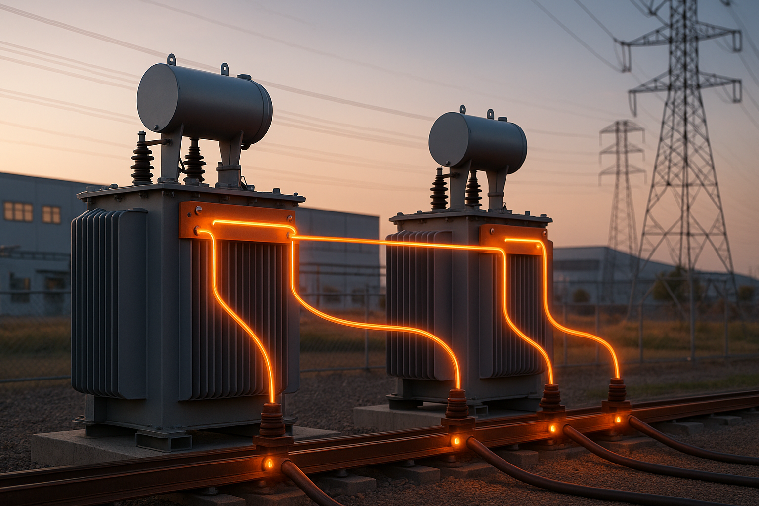

In electrical engineering, transformers are a very integral part of the design. Without them, the electrical supply cannot be given to a certain area. Often, engineers think of ways to optimize the use of transformers most efficiently. One such method is to connect transformers in parallel. This has been a proven way for a long time for efficient and reliable operation. Instead of using a single heavy load transformer, you can use smaller multiple load transformers. So why is this technology adopted? We will see in this post why we need to connect transformers in parallel.

  1. When you have multiple transformers of the same capacity (meaning a single one is of 22 KV, then you can use two transformers of 11 KV each), then load sharing can be done. So, you can either use both the transformers for full load capacity, or use only one in case of low power requirement. This provides great flexibility in operation.
  2. Continuing the above point, you can shut down one transformer in case of any maintenance activity. The other one can supply a load, not full, but only to critical loads. The non-critical loads can remain off for a few hours according to your requirement.
  3. As multiple transformers mean a single transformer of a lower rating, no load loss occurring will be of a lower value than using a single heavy-rated transformer.
  4. Overall cost of maintenance, installation, and commissioning is reduced to a great extent in this setup and becomes very economical, instead of a single transformer.
