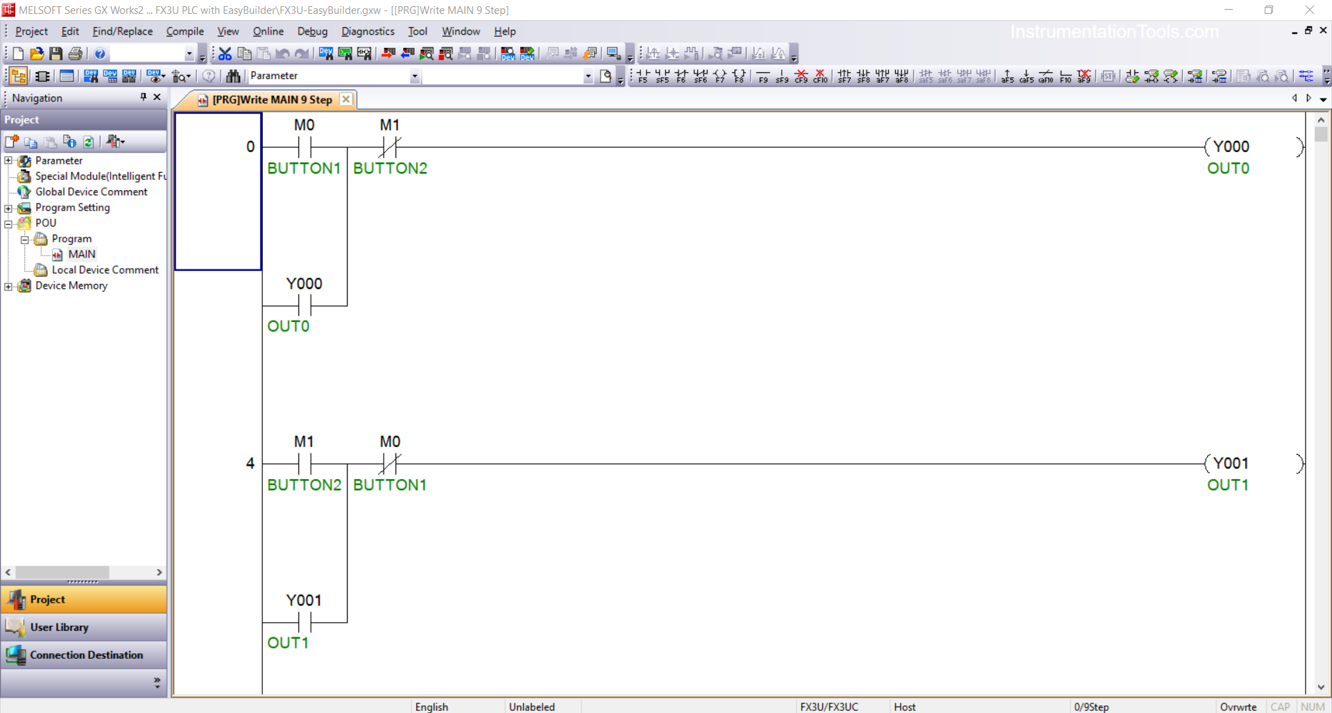

2. Write the PLC Program
1. Create the program you want to simulate. An example is shown below.

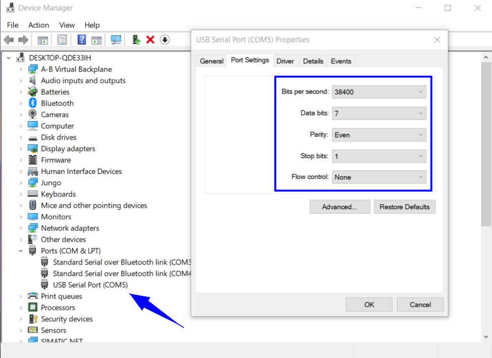

2. Ensure the PLC connection is active by checking the communication port connected to the PC via Device Manager.
In the example below, the USB to Serial RS-232 adapter is connected to Port 5, with the following settings: Bit Rate: 38.4 Kbps, Data Bits: 7, Parity: Even, and Stop Bits: 1.
Make sure these settings match the configuration used on the PLC device.

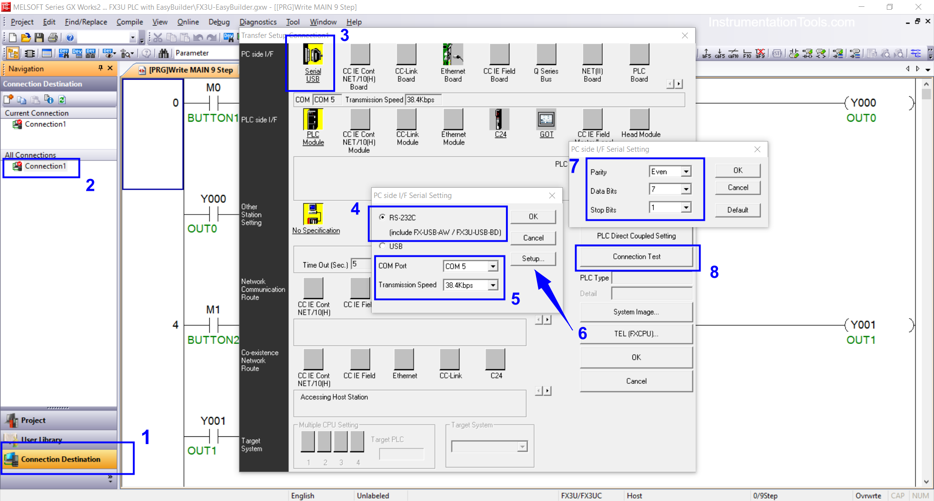

3. Open the menu Connection Detection → Connection1 and set the communication parameters as follows:
Select the Serial USB interface with type RS-232C, specify COM Port 5, set the Transmission Speed to 38.4 Kbps, then in the Setup, configure Parity: Even, Data Bits: 7, and Stop Bits: 1.
Verify the connection by clicking Connection Test — if a notification appears saying “Successfully Connected with the FX3U/FX3UC CPU”, it means the connection between the PC and PLC has been successfully established.

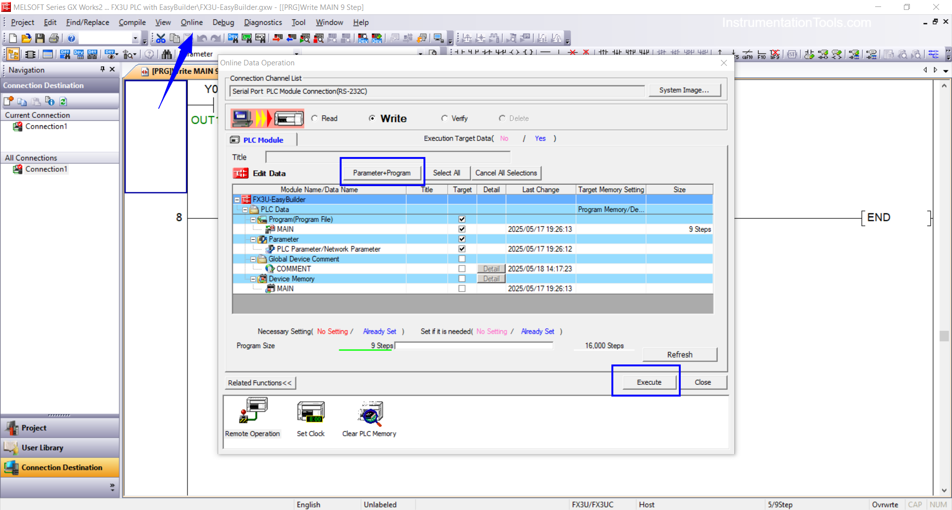

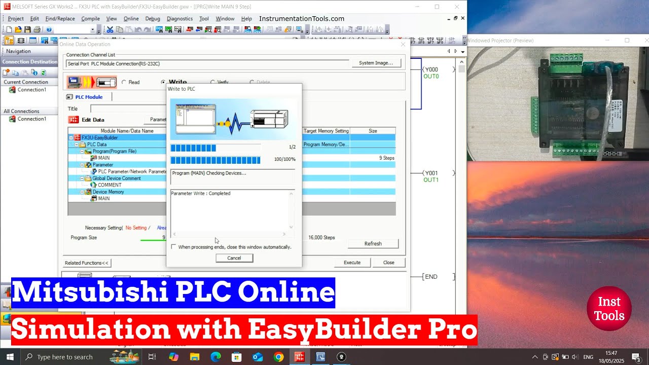

4. After the connection is established, click the “Online” menu and select “Write to PLC”.
5. Specify the program section to be transferred (“Parameter + Program”) → press “Execute”. When a confirmation pop-up appears indicating that the transfer was successful, the program has been uploaded to the PLC memory and is ready to run.

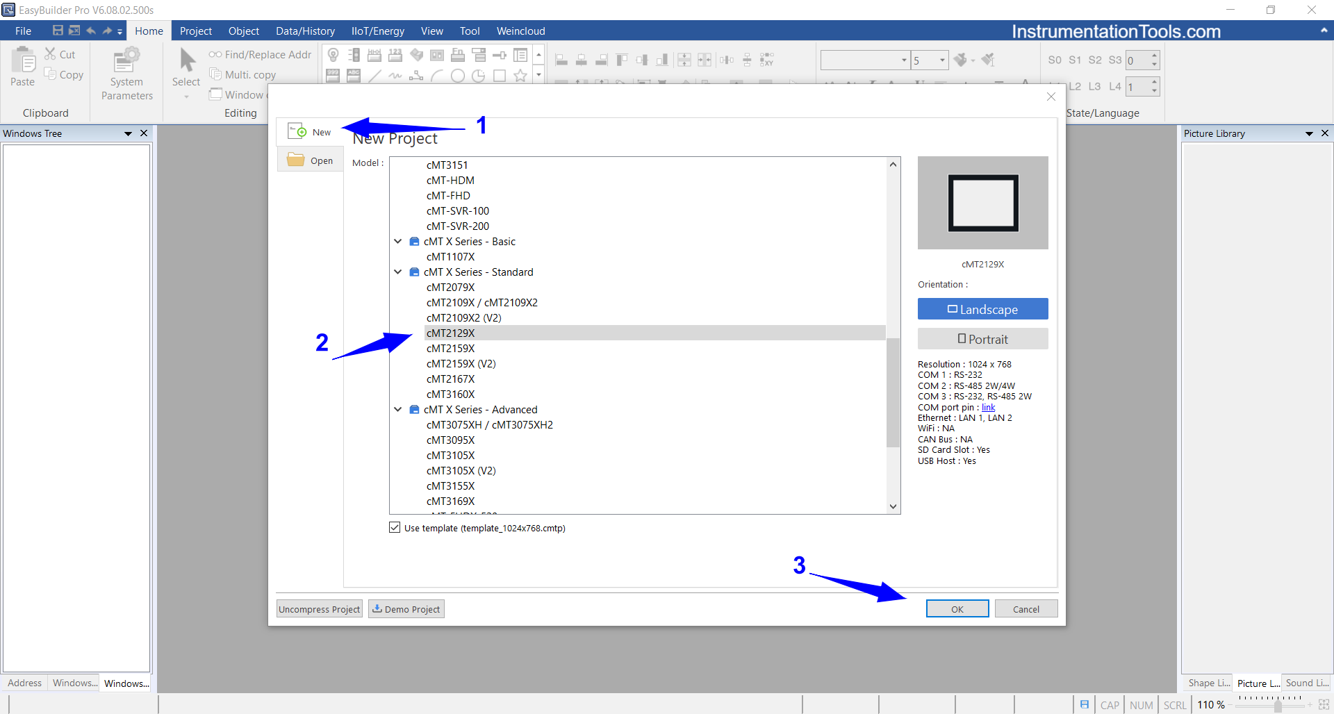

1. Open EasyBuilder Pro and create a new project. Click → New → select the HMI type used → OK.
EasyBuilder Pro Online Simulation

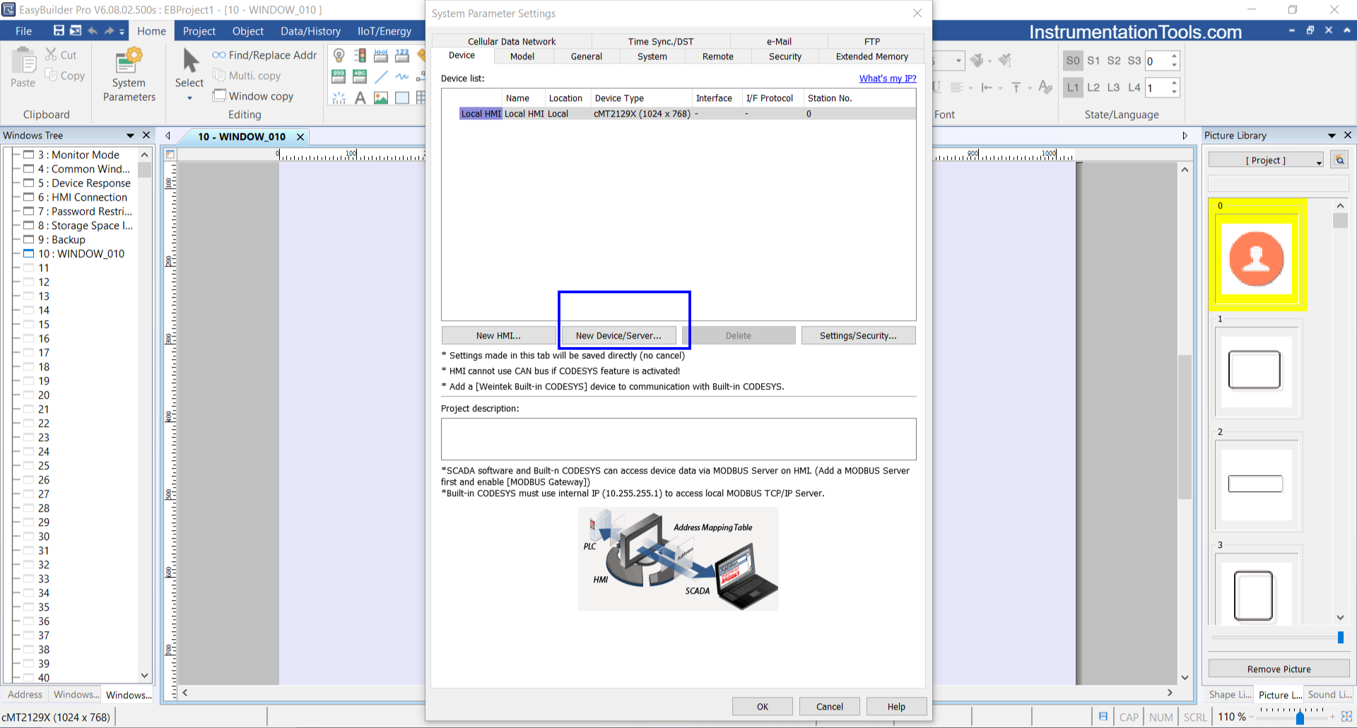

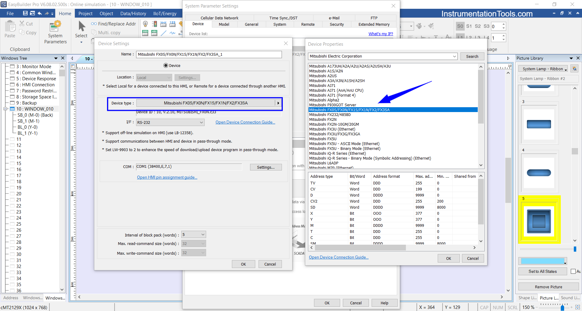

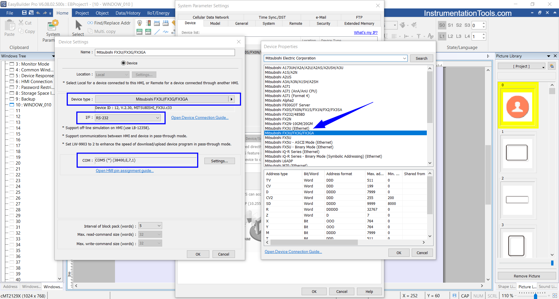

2. In the “System Parameter” pop-up menu, click → New Device/Server.
Weintek online simulation
3. Set the parameters: Port → “RS-232”, COM → “COM5(*)(38400,E,71)”, Device type → “Mitsubishi FX3U/FX3G/FX3GA” → click “OK”.
EasyBuilder Pro Weintek HMI Software

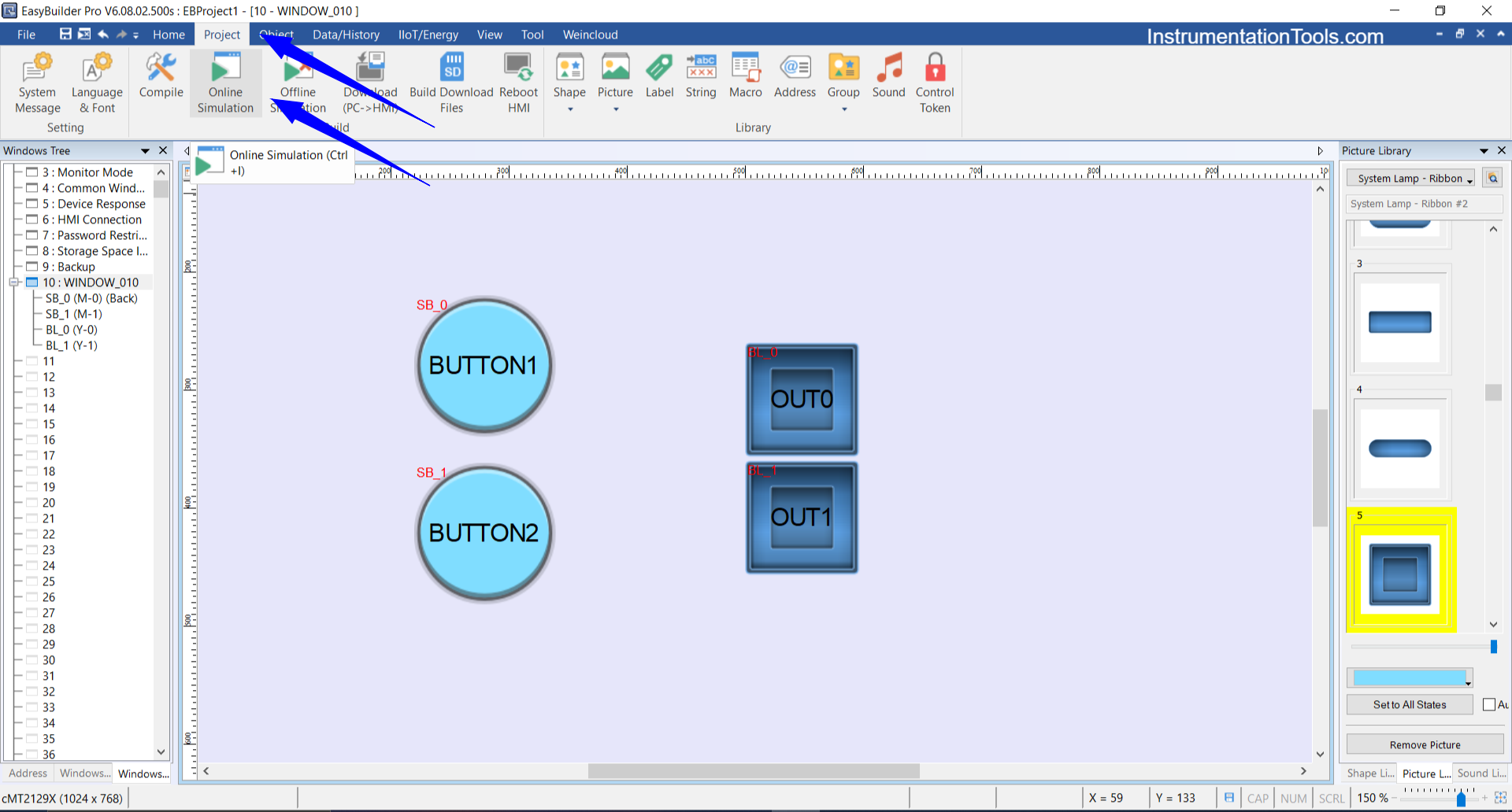

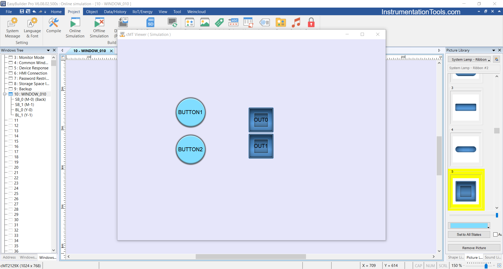

4. Create the interface design using the input and output address parameters according to the PLC program you’ve created. Click the “Project” menu → select “Online Simulation”.
Free Weintek Easybuilder Pro HMI development software
5. Wait, and the simulation screen will appear as shown below. The connection is successful, and the PLC is connected to EasyBuilder Pro.
Weintek EasyBuilder Pro software tutorial
6. If the “Device Not Responding” notification appears in EasyBuilder Pro, it indicates that the connection between the PLC and HMI has failed.
The solution is to change the Device Type in the “System Parameter” of EasyBuilder Pro (e.g., from “FX3U/FX3G/FX3GA” to “FX0S/FX0N/FX1S/FX1N/FX2/FX3SA”), as some models like FX3U-14MT may have compatibility bugs.
