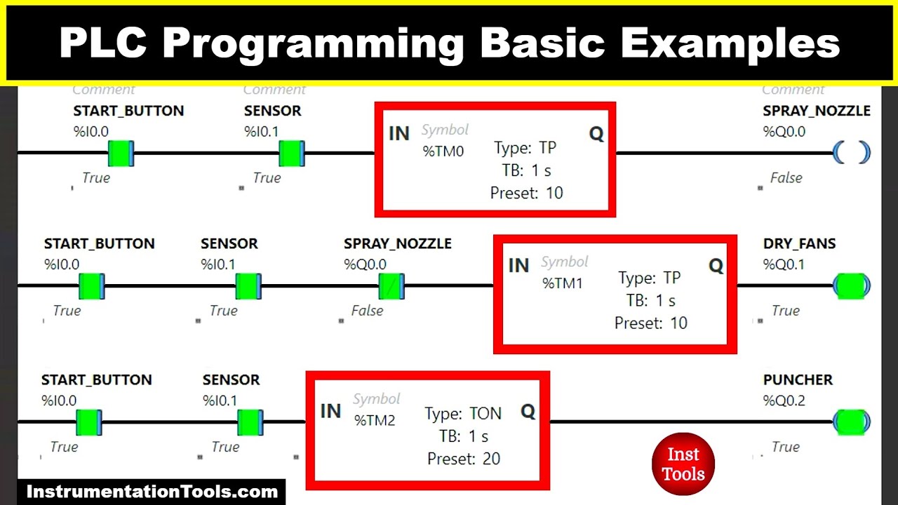

PLC Programming Basic Examples - Paint Spraying Booth
666 views Dec 11, 2023
In this video, you will learn the PLC programming basic examples which is paint spraying booth application. *** Industrial Automation Tutorials and Courses *** PLC Tutorials https://instrumentationtools.com/category/plc/ Ask Your Questions Here https://engineerscommunity.com/c/plc/18 PLC and SCADA Courses https://automationcommunity.com/ Advanced PLC and HMI Training Course https://instrumentationtools.com/advanced-plc-programming-training-course/ Omron PLC Training Course https://instrumentationtools.com/omron-plc-online-training-course/ Siemens Tia Portal Course
