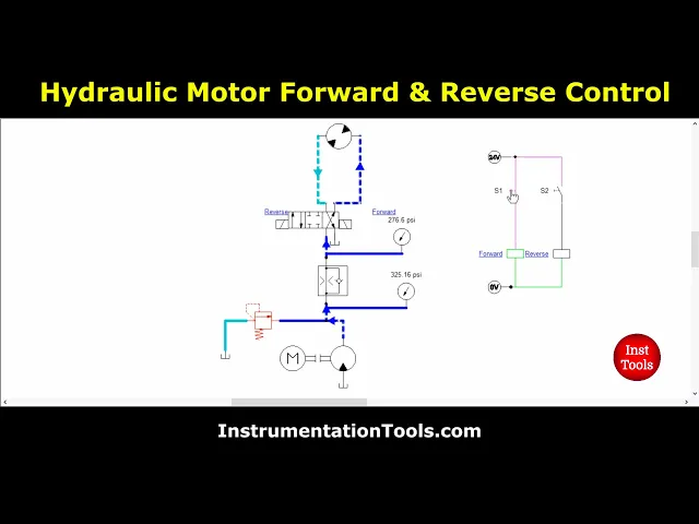

In this video, we’ll demonstrate how to control the forward and reverse movement of a hydraulic motor, achieving both clockwise and counterclockwise rotation for various applications. We’ll also explain how to manage the flow rate using a flow control valve. The motor direction is controlled by a directional control valve, operated through solenoids activated by switches. Watch to learn how directional flow and speed are effectively managed for precise hydraulic motor control. Read the Hydraulic Motor Article: https://instrumentationtools.com/hydraulic-motor/ #hydraulic #hydraulicmotor #hydraulicmachine Tags: hydraulic motor control, forward and reverse, hydraulic system, directional control valve, flow control, hydraulic schematics, motor control, reverse flow, hydraulic tutorial, engineering guide, hydraulic motor, forward control, reverse control, hydraulic valves, directional control valve, hydraulic actuator, engineering tutorial, industrial automation, fluid control, diy hydraulics
