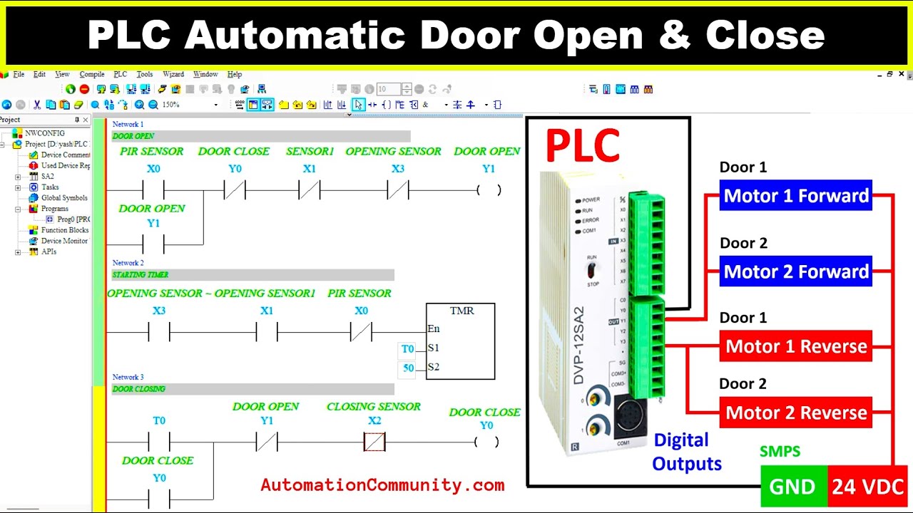

PLC based Automatic Door Opening and Closing System
40K views Apr 19, 2023
In this video, you will learn the PLC based automatic door opening and closing system using ladder logic programming. ## Learn PLC Programming using Examples ## 1. Free Download PLC and HMI Software https://bit.ly/AutomationCommunityPLC-1 2. Introduction to PLC Programming https://bit.ly/AutomationCommunityPLC-2 3. Design IO Simulator in PLC https://bit.ly/AutomationCommunityPLC-3 4. HMI Simulation of IO Simulator https://bit.ly/AutomationCommunityPLC-4 5. Control Blinking Rate of Light PLC Logic https://bit.ly/AutomationCommunityPLC-5 6. HMI Programming of Blinking Light https://bit.ly/AutomationCommunityPLC-6 7. Two way switch logic in PLC https://bit.ly/AutomationCommunityPLC-7 8. HMI Design for Two way switch
